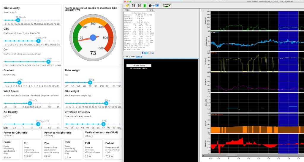

OK. I have a ride that I did a couple of weeks back. It shows average power as only 43W, which I am sure isn't right. Could you have a look and tell me if it is wrong in some way?

Re: Oh dear oh dear.
Your ride file shows an average bike speed of 9 mph.
Also, there is a lot of zero cadence (not pedaling).
Both of these things will keep watts low.
I used aerocoach to check your parameters.
Assuming the weight/speed information is correct, then I think your watts are correct.
- Screen Shot 2020-09-15 at 12.50.29 PM.png (191.67 KiB) Viewed 33070 times
