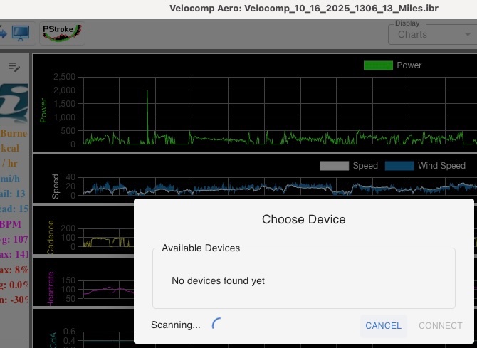

I deleted and successfully reinstalled the driver. I did a hard restart of my Newton. Then I tried to connect to both AV and Isaac. Isaac said it had connected to my Newton, but it wont recognize my device. AV just endlessly scanned for devices. Obviously, it is set for wireless, but I cannot see how to set it for a hard wired connection.

Isaac says my device is connected, but it does not turn the network symbol green, not respond when I try to download rides. And, even though I quit Isaac, ASV still just endlessly searches for a device. Is there a way to turn off wireless, or force AV to use the USB serial port?

I don't think your Silicon Labs drivers are properly installed.
When installed correctly, you should see a green box around the USB icon, both in Isaac and VA, when you connect your Newton.
Note that you cannot have both Isaac and VA running at the same time.
The "choose device" image you show for VA happens when the USB connection is not made, and VA looks instead for a Bluetooth connection. This cannot work with Newton, because there is no Bluetooth chip inside the Newton.
It's also possible that your internal connection in your Newton is no longer functioning properly; that too could cause inability to connect with your software.

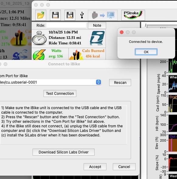

Thanks for your patience. I have alternated quitting Va and Isaac when I tried to connect, since you told me that before. When I do the Silicon Labs install, which I have done three times now, it shows me that it is installed correctly. Thanks for clarifying that the default comms path for VA is the USB port. I have tried to eliminate the cable as a source of the issue by trying three different cables. I am starting to think that it might be the port on my Newton. But, I am still curious why Isaac tells me that the device is connected, as my graphic “1” shows.

gkuchel wrote: Thu Oct 23, 2025 7:36 pm Hey John,
Thanks again,
Gary K
The Isaac "Connect to iBike" window shows only when the USB connection is not good. Sadly, I think your Newton USB internal connector is not working; if the connection were good you would see a green box around the USB icon.
