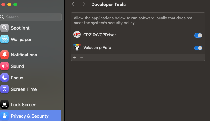

Wireless is a great step forward for those who have a wireless device. However, my Newton obviously is not, and ever since accepting the upgraded Velocomp Aero software, my newton is no longer detected as connected by hardwire. I am using the same connecting wire that I have used for quite some time, but the “download files” and “network” icons do not turn green. Is there a way to roll my software back to the non-wireless, for testing if nothing else?

gkuchel wrote: Tue Oct 21, 2025 10:33 am Wireless is a great step forward for those who have a wireless device. However, my Newton obviously is not, and ever since accepting the upgraded Velocomp Aero software, my newton is no longer detected as connected by hardwire. I am using the same connecting wire that I have used for quite some time, but the “download files” and “network” icons do not turn green. Is there a way to roll my software back to the non-wireless, for testing if nothing else?

Go to the Security and Privacy settings of your Mac. You will likely find that you need to accept the Silicon Labs driver. That should fix your connectivity problem.

No Joy. Perhaps I didn’t add the driver correctly.
Security screenshot.png (64.47 KiB) Viewed 125 times

gkuchel wrote: Tue Oct 21, 2025 9:01 pm No Joy. Perhaps I didn’t add the driver correctly. Security screenshot.png
Try reinstalling the driver.

I deleted and successfully reinstalled the driver. I did a hard restart of my Newton. Then I tried to connect to both AV and Isaac. Isaac said it had connected to my Newton, but it wont recognize my device. AV just endlessly scanned for devices. Obviously, it is set for wireless, but I cannot see how to set it for a hard wired connection.

gkuchel wrote: Wed Oct 22, 2025 6:08 pm I deleted and successfully reinstalled the driver. I did a hard restart of my Newton. Then I tried to connect to both AV and Isaac. Isaac said it had connected to my Newton, but it wont recognize my device. AV just endlessly scanned for devices. Obviously, it is set for wireless, but I cannot see how to set it for a hard wired connection.

If you can connect Isaac to your Newton, then VA should work as well. Make sure Isaac is not running when you attempt to connect to VA.
