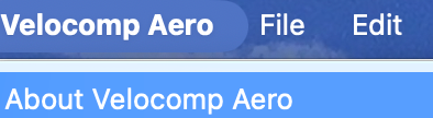

INSTEAD, QUIT VELOCOMP AERO AND THEN RELAUNCH VELOCOMP AERO, BEFORE STARTING ANY FIRMWARE UPDATE

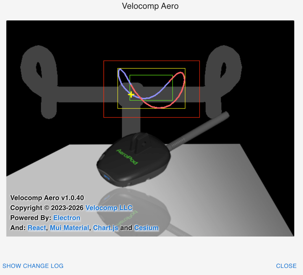

AFTER RESTARTING VA, IF YOU SEE A MESSAGE SAYING A NEW VERSION OF VELOCOMP AERO IS AVAILABLE, DO THE VELOCOMP AERO UPDATE FIRST, BEFORE STARTING ANY FIRMWARE UPGRADE.
AFTER COMPLETING THE VA SOFTWARE UPGRADE, CHECK TO SEE THAT YOU HAVE THE LATEST VERSION 1.0.40 OR HIGHER INSTALLED
AFTER YOU HAVE CONFIRMED THAT YOU HAVE VERSION 1.0.40 OR HIGHER INSTALLED, IF YOU THEN SEE A "FIRMWARE UPDATE IS AVAILABLE" MESSAGE, IT IS OK TO PROCEED WITH THE FIRMWARE UPDATE.
