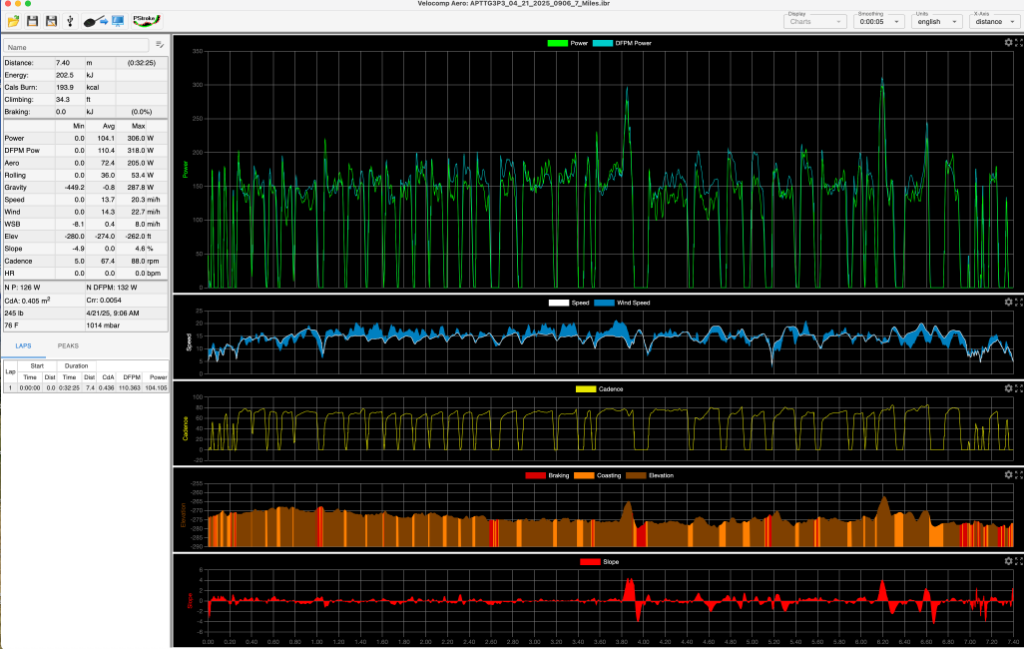

1) Open your ride in VA.
Screenshot0 .png (264.53 KiB) Viewed 17575 times

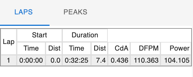

2) To the left of the graphs, click on the Laps tab. Underneath you will see a list of the laps for your ride. In this example there is only one lap, which covers the entire ride.
Screenshot2 .png (24.4 KiB) Viewed 17575 times

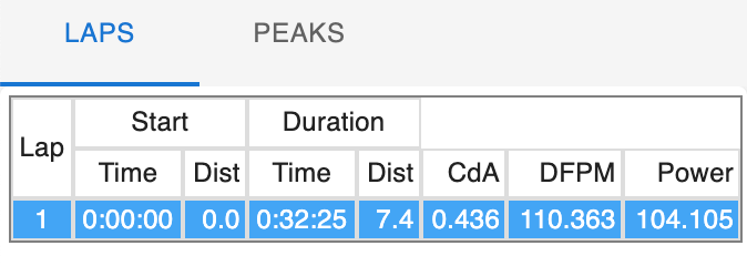

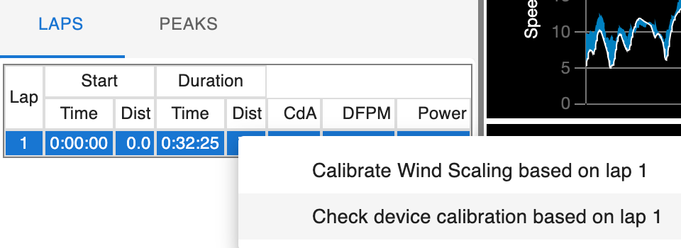

3) Click on the lap(s) you wish to analyze. If it's more than one lap, hold down the Option key to select multiple laps. The lap(s) you select will be highlighted in blue, with white type:
Screenshot3 .png (25.17 KiB) Viewed 17575 times
4) with your mouse positioned over one of the laps, right click. You will see a context menu appear that will allow you to adjust wind scaling, or analyze the laps selected:
Screenshot4 .png (53.05 KiB) Viewed 17575 times

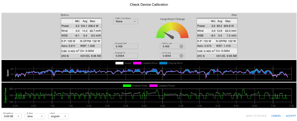

5) Click on your selection (in this example I selected "check device calibration"); this graph will appear
Screenshot5 .png (126.14 KiB) Viewed 17575 times
6) To accept the changes click "Accept"
7) After you Accept the results, go to Edit Profiles and select "Extract From Ride File" to get the corrected profile, and then use "Send To Device" to load it into your unit.
Alternatively, if your device is connected while the "Check Device Calibration" dialog is open (step 6), you can use the SEND TO DEVICE button at the bottom to update the device.

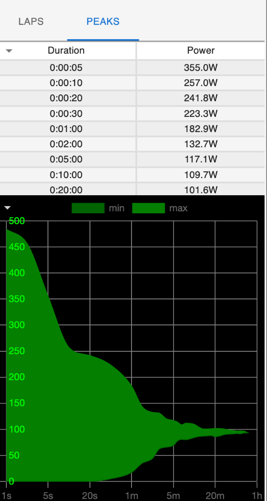

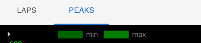

We've added a list version in the latest version of VA. In the Peaks tab, click on the yellow triangle at the top of the graph to reveal the numbers:
