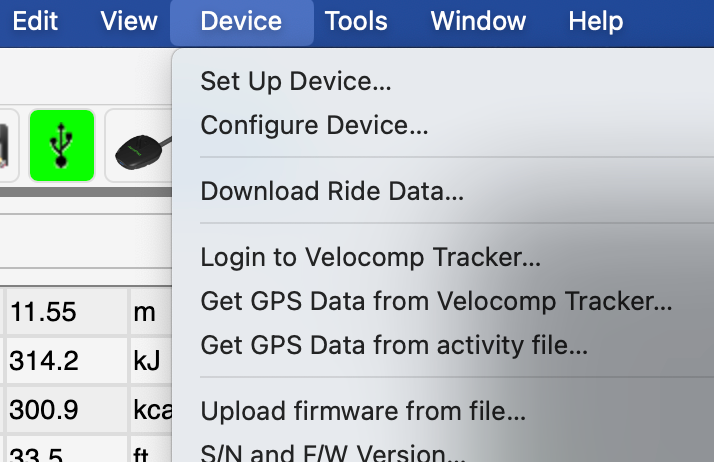

There is no "Device>Connect>Dropdown" menu item in VA, so I don't know what you are talking about...

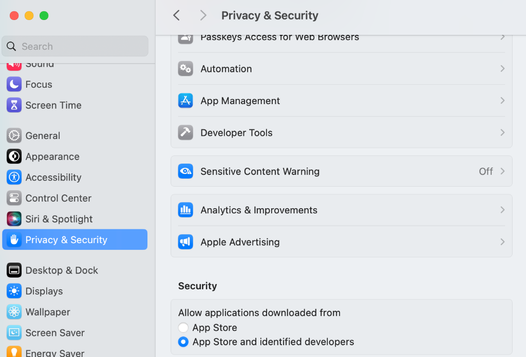

Reload the SiLabs driver, and make sure you check "System Settings/Privacy and Security/Security"...and allow the SiLabs driver to load.
