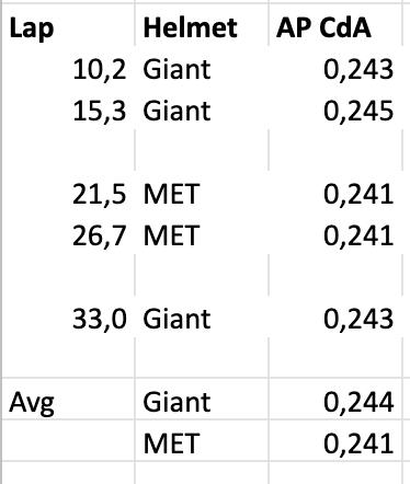

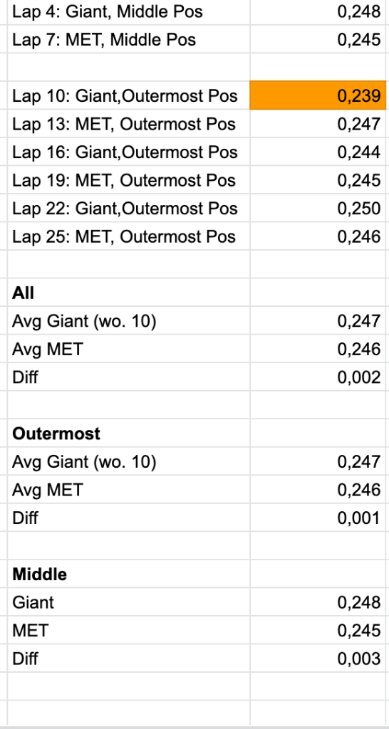

I am comparing two helmets (Giant Rivet TT vs Met Drone). I'm riding on my tt-bike, but with training wheels and in training kit, so the absolute CdA-numbers aren't impressive. However, I'm able to reproduce a difference in CdA of about 0.002 between these two helmets across two sessions on different days, in different conditions. This is something like 3 watts at race pace - enough to matter, but a small difference. I think that is pretty good for outdoors testing.
Session 1, 2020-06-27:
Session 2, 2020-08-28:

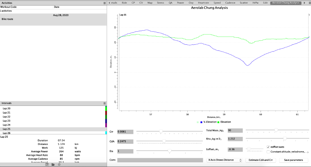

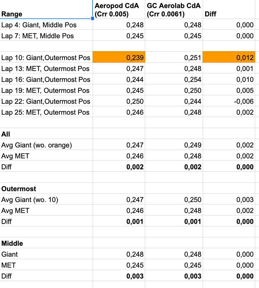

Just to follow up, I think I've figured out how to use Aerolab in Golden Cheetah (v3.5). Using weather station data from the day to calculate air density and the Aerolab settings in the picture below, I got the following CdA estimates:
As you can see, the overall conclusion re: the two helmets is exactly the same, although there are variations at lap level (I had to manipulate Crr to match absolute CdA levels, but that doesn't concern me). For me this further validates the Aeropod numbers.

Re: Testing of helmets - success reproducing results across sessions
Thank you. I just make an assumption about Crr, I have no way of testing it. The way I test, I'm effectively solving one equation with two unknowns, Crr and CdA. So yes, I'm looking for relative gains; as long as I'm improving my CdA, the absolute value matters less.
