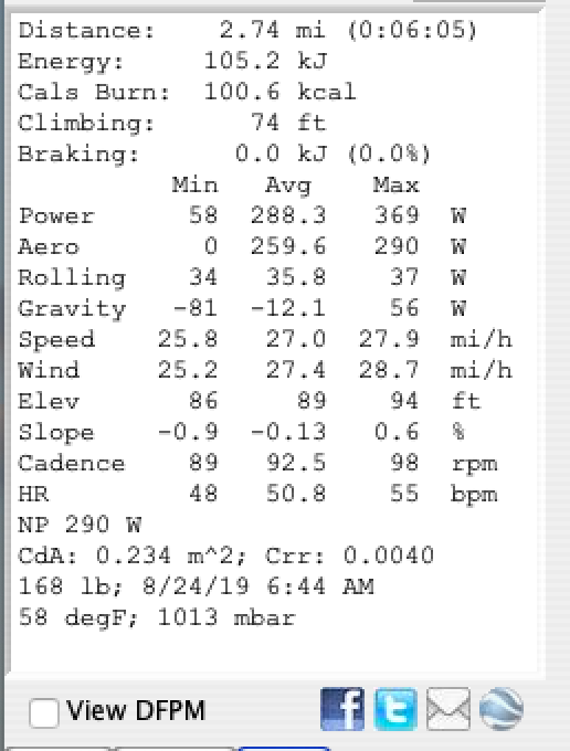

1) You have 6 tests, each about six minutes long. I highlight each test separately (where speed is stable during the test), then use the command “File/Combine-Split/Keep Selection Only” to create 6 files, each having the test data only. I name them Test 1, Test 2, etc.
2) I open each file (for example, Test 1). Since you are in a closed loop, average wind speed should be the same as average bike speed, and average slope should be zero. I observe that wind speed (27.4) is a bit higher than bike speed (27.0), and average slope is -0.13%.
Screen Shot 2019-08-25 at 10.09.36 AM.png (60.66 KiB) Viewed 3058 times
So, Test 1 definitely needs some tweaking!

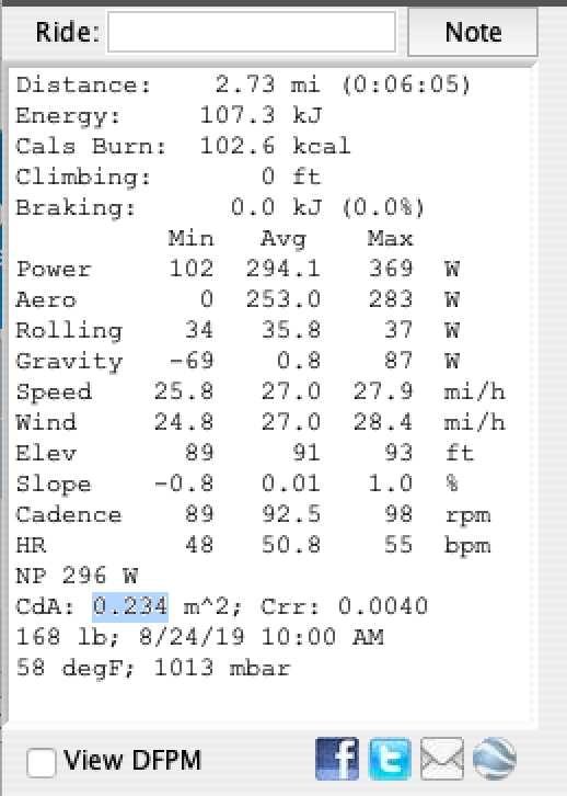

3) To correct the slope and wind errors I use the “Analyze/Analyze Route” command, which corrects for slope drift and non-zero net wind speed. After analysis the average wind speed is 27.0 and the average slope is 0.00%. So, we now have a good set of test data.
Screen Shot 2019-08-25 at 10.11.40 AM.png (46.57 KiB) Viewed 3058 times

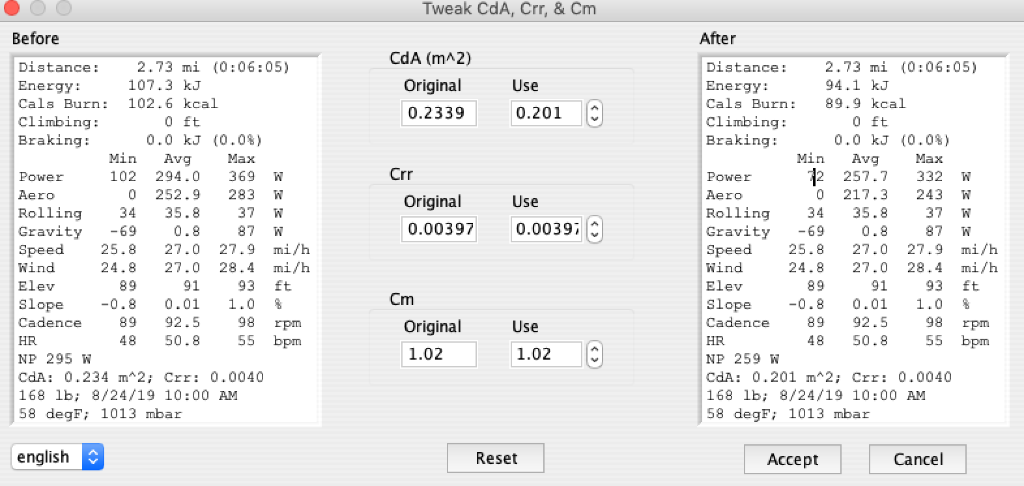

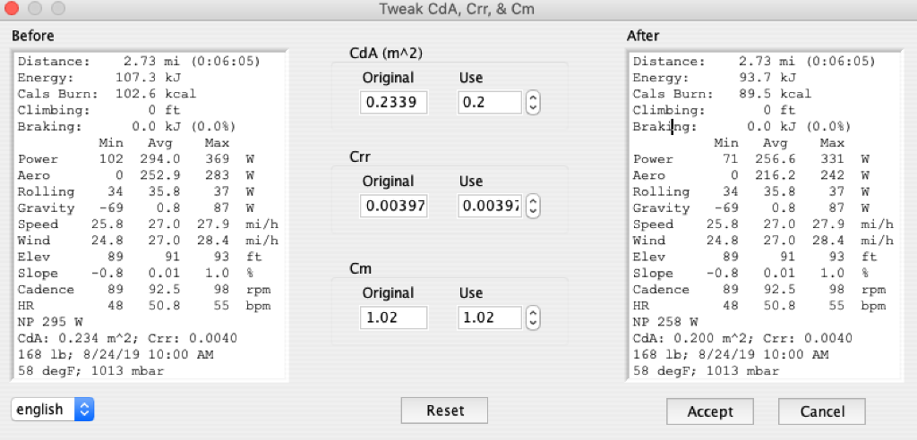

I use the command "Analyze/Tweak CdA", and then I GUESS a lower value of CdA. Lower CdA will reduce AP watts. My first guess of 0.200 lowers AP watts to 256.8—two watts too low.
Screen Shot 2019-08-25 at 9.57.28 AM.png (129.18 KiB) Viewed 3058 times
My second guess is 0.202—high by about 0.2W.
Screen Shot 2019-08-25 at 9.58.11 AM.png (145.89 KiB) Viewed 3058 times
I go to 0.201, now about 1W low.
Screen Shot 2019-08-25 at 9.58.55 AM.png (145.25 KiB) Viewed 3058 times
So, interpolating between the two, the CdA for Test 1 is 0.2019 . I save this file as “Test 1_Corr”
