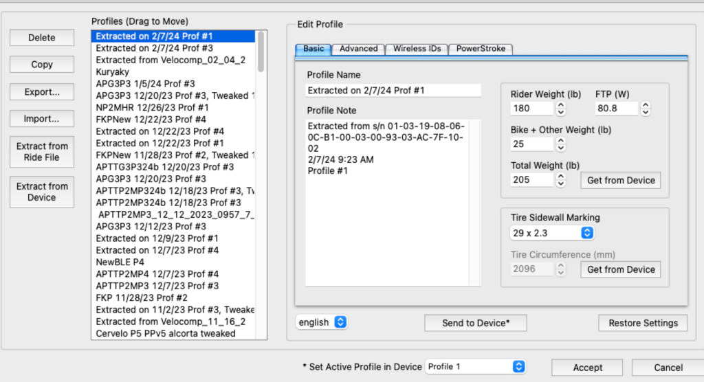

Let's work on one bike and one powerpod at a time. Because you have so many variables in play we are going to need to do this slowly so that we can figure out what is going on:
1. For the PP you use with your two mtbs, connect your PPMTB (the PP you use with your mountain bikes) to Isaac
2. Go to "Edit/Edit Profiles"
3. Click the button "extract from device". This will show the active profile in your device. TAKE A SCREEN SHOT OF WHAT YOU SEE (in my example it is profile 3)
Screen Shot 2024-02-07 at 9.21.06 AM.png (186.27 KiB) Viewed 70693 times

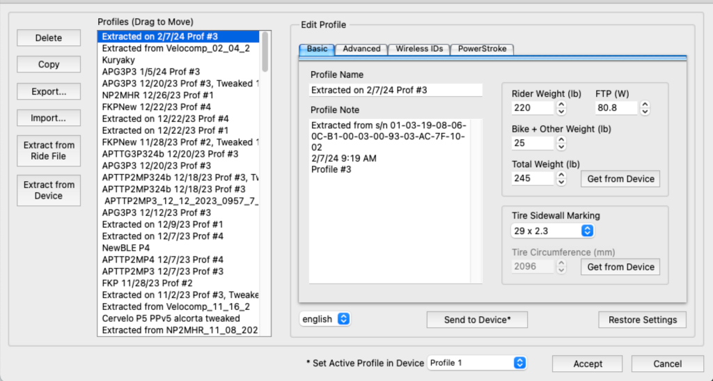

4. At the bottom of the window use the dropdown menu "Set Active Profile in Device" to profile 1
Screen Shot 2024-02-07 at 9.22.14 AM.png (184.71 KiB) Viewed 70693 times
5. Click the "Extract from Device" button. You will extract profile 1 from your PP into Isaac, and it will be labeled as such:
Screen Shot 2024-02-07 at 9.24.34 AM.png (189.36 KiB) Viewed 70693 times

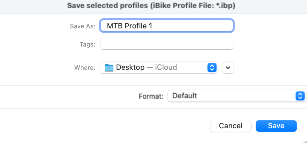

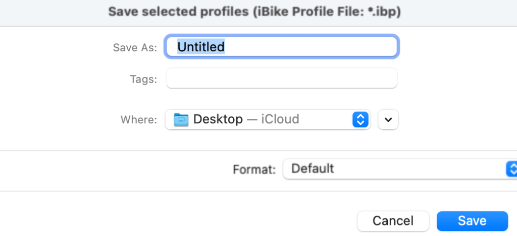

6. Click the "Export..." button; you will see a screen something like this:
Screen Shot 2024-02-07 at 9.25.56 AM.png (83.76 KiB) Viewed 70693 times
7. Replace the highlighted word "untitled" with the word "MTB Profile 1"

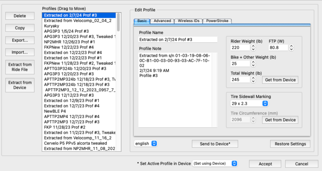

hello i got it.
PP2 profile2
PP2 profile1
Re: TIRED 5 years and still useless
Posted: Wed Feb 07, 2024 10:18 pm
You did not do as I asked.
You provided profiles 1 and 2, but did not provide profiles 3 and 4.

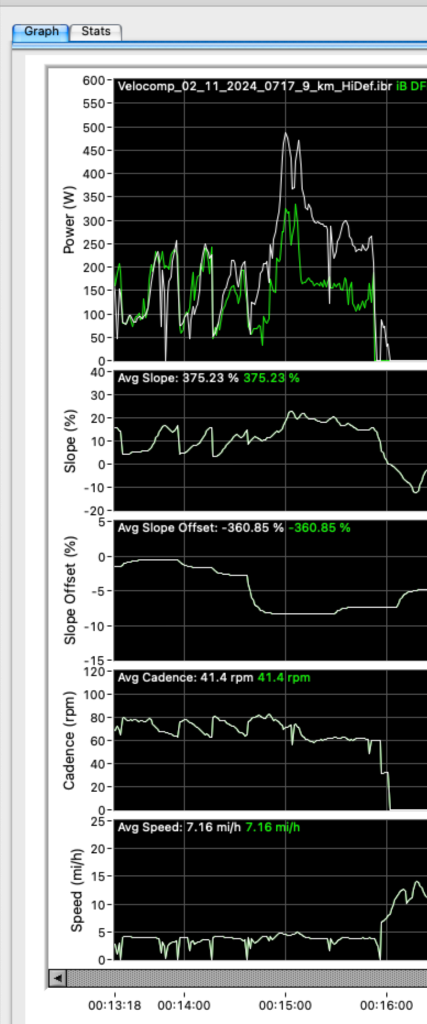

i going out today to ride on my camber PP2 Profike 2.
the powerpod record something.
here are the files.
xtrage the PP just record 1 hour but my ride was 2.
Posted: Sun Feb 11, 2024 8:54 am
by Kuryaky
another ride PP2 profile 2 camber either share you my garmin with my dfpm file .fit
now the powerpod its recording but my ride was 1 hour and just record 40 minutes.

I have looked at your ride files and something sticks out: most of the time your bike speed is only about 4 mph.
Also: there are gross discrepancies between your elevation-measured slope and the accelerometer slope. Is this ride from a mountain bike? If so do you have your front fork locked-up? If this ride was on your MTB and you did not have the front fork locked, that would explain the issues.
Please post photos of the bike you used in this ride. I know you have two bikes; the road bike Pinarello should be fine.

Here is what appears to be going on:
1) On your MTB your lockout seems to not totally prevent your front fork from moving up and down. In general, your PP works well on your MTB. However, at the end of your climb, where you have a really steep slope, your front fork compression changes, causing the PP angle to change, causing high watts. I know this because the PP adjusts its settings continuously in response to changes in mounting angle. If there is no change in PP orientation, the "slope offset" number remains nearly constant, but on your steep hills (around time 14:30) the slope offset number goes crazy, as does the difference between PP watts (white) and DFPM watts (green).
Screen Shot 2024-02-22 at 8.50.06 AM.png (149.7 KiB) Viewed 70035 times
This means that something is causing its angle to change. Does your MTB also have rear adjustable forks?
2) Your road bike ride looks fine. There are no issues with your PP performance; therefore, I conclude that your PP is working properly.
To summarize: I think your PP works well on your road bike. Most of the time your PP also works well on your MTB, but if the front fork pumps AT ALL, then where it does your PP will have problems.
