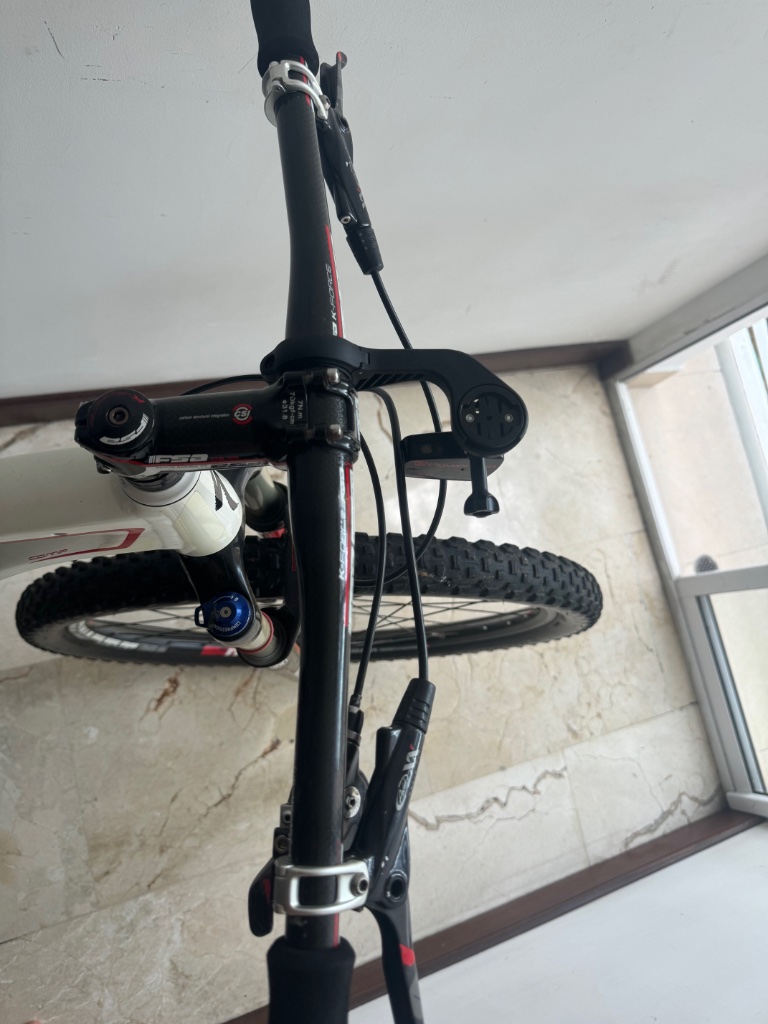

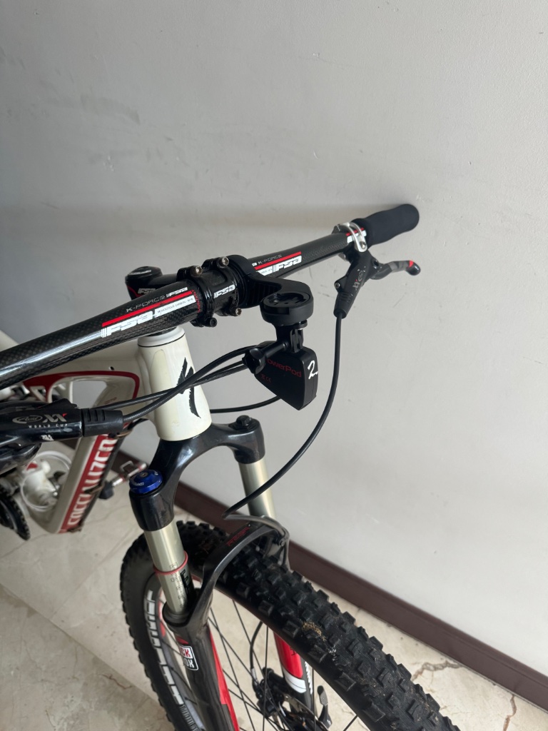

You say you have 2 PowerPods. For BOTH PP, please do the following:

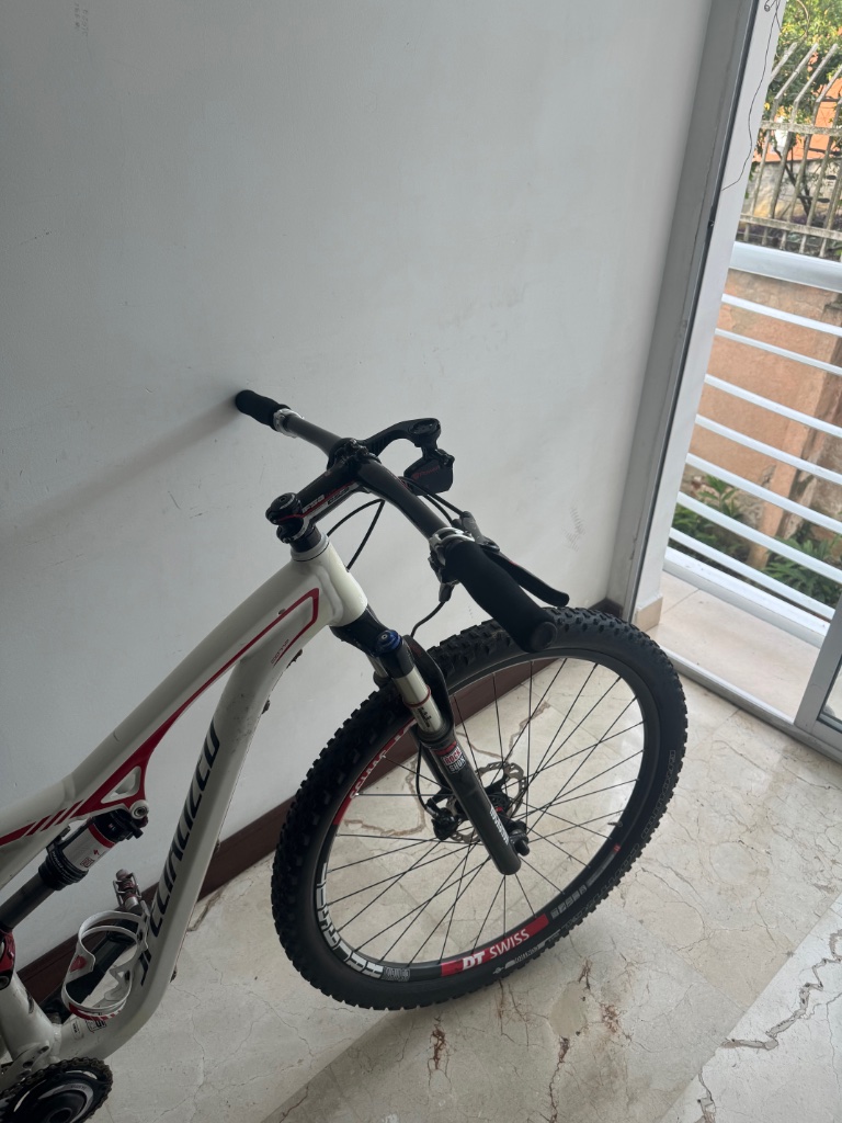

1. Attach a PP to your bike
2 Take pictures of PP as mounted on your bike: front and side views. The side view should how the unit is angled with respect to the ground.
3. Connect PP to Isaac. Go to "Edit/Edit Profiles". Click "Extract from Device"--this will provide the profile currently stored in your unit.
4. Click the "Export" button to export your profile to your desktop. Make sure to name the profile in a way that identifies it with your profile: "Profile bike 1" or "Profile bike 2".
5. Repeat steps 1-4 for your other PP.
Please post photos and profiles. After analyzing them I will provide next steps.

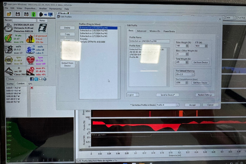

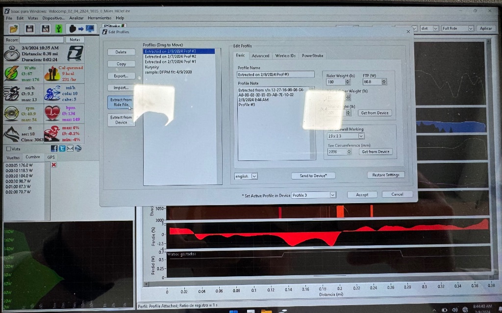

Re: TIRED 5 years and still useless

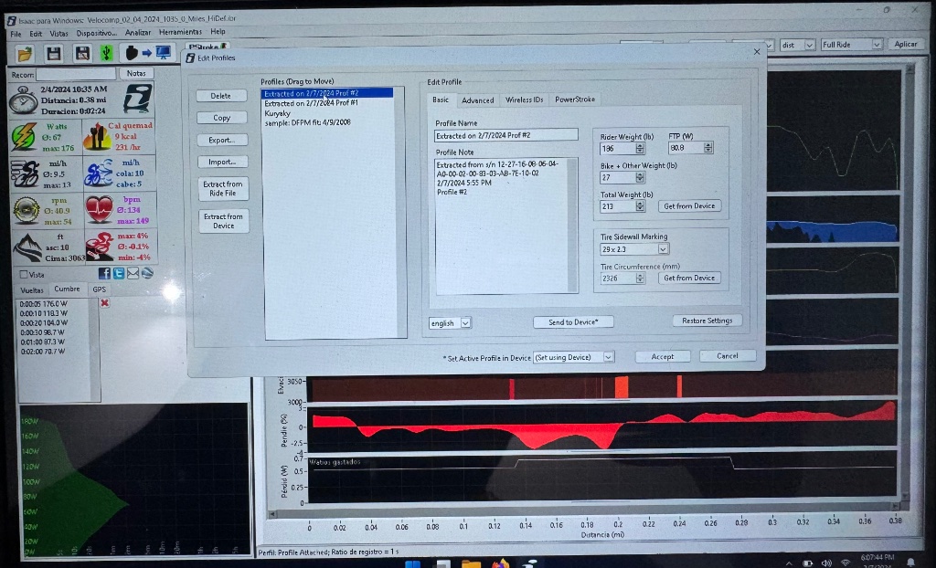

I go out to the bike park, and wipe all bought two PP.
And star again.
I bring 3 of my bikes 2 MTB PP 2.
And my road bike Pinareello F8 PP 1.
Looks de PP2 record ok.
PP 1 don’t record nothing.
I didn’t see your message before.
And star again.
- Velocomp_02_04_2024_1055_0_Miles_HiDef.ibr
- (13.17 KiB) Downloaded 306 times
- Velocomp_02_04_2024_1035_0_Miles_HiDef.ibr
- (17.02 KiB) Downloaded 286 times

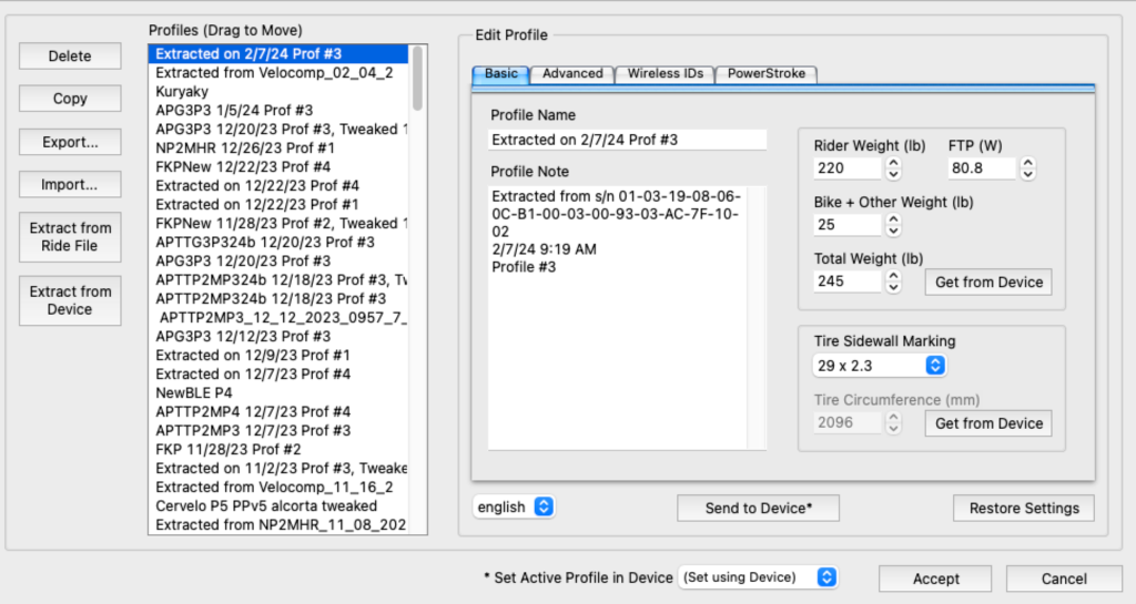

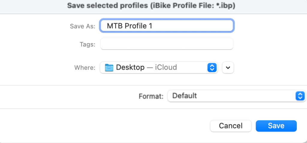

1. For the PP you use with your two mtbs, connect your PPMTB (the PP you use with your mountain bikes) to Isaac
2. Go to "Edit/Edit Profiles"
3. Click the button "extract from device". This will show the active profile in your device. TAKE A SCREEN SHOT OF WHAT YOU SEE (in my example it is profile 3)
4. At the bottom of the window use the dropdown menu "Set Active Profile in Device" to profile 1
5. Click the "Extract from Device" button. You will extract profile 1 from your PP into Isaac, and it will be labeled as such:

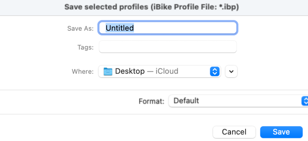

6. Click the "Export..." button; you will see a screen something like this: 7. Replace the highlighted word "untitled" with the word "MTB Profile 1"
8. Go back to step 4, and repeat steps 4-7 for profile 2, 3 and 4, making sure to label the corresponding exported profiles 2, 3 and 4
9. Post here your screen shot and your four profiles.
This will let me understand what is currently in your PPMTB. After that we will proceed to the next steps.

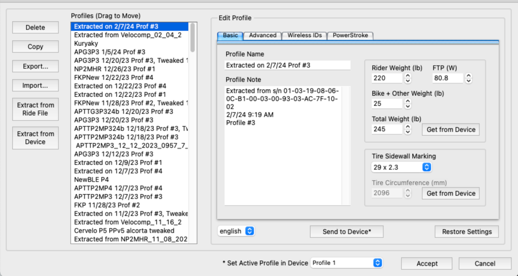

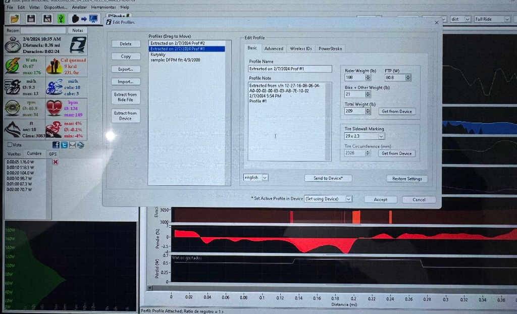

hello i got it.
PP2 profile2
PP2 profile1
PP2 profile2
PP2 profile1
- IMG_2538.jpeg (249.96 KiB) Viewed 13743 times
- IMG_2537.jpeg (264.18 KiB) Viewed 13743 times
- PP2 Profiles.zip
- (855 Bytes) Downloaded 368 times
I never never use profile 3 and 4.
I will post it later.
Bought are empty, and the forum just let me upload 3 files per post.

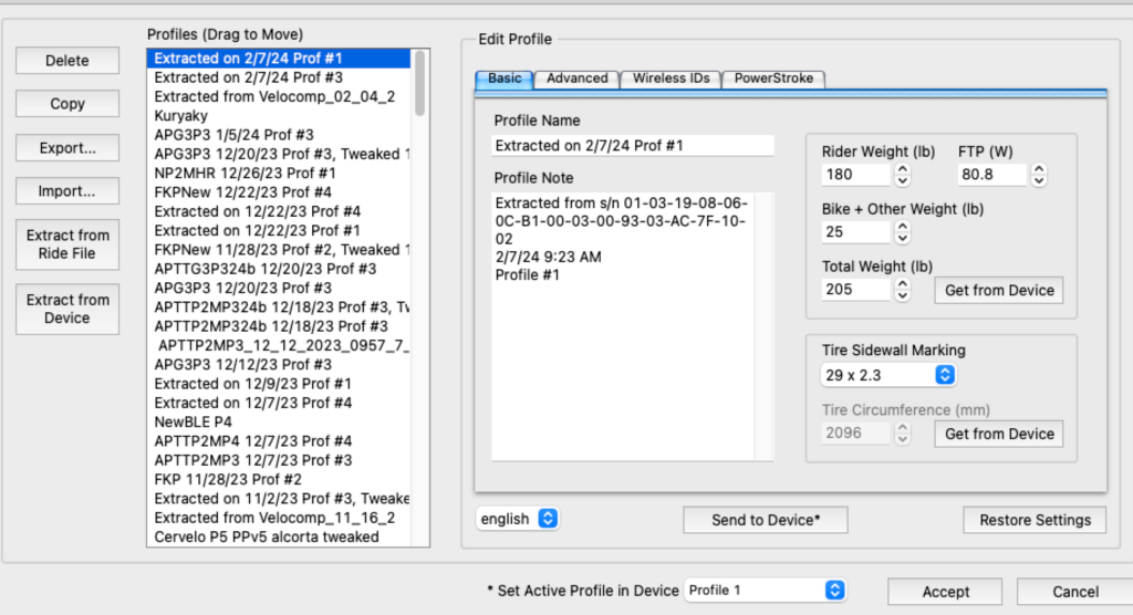

Post Profile 3 and 4
- IMG_2545.jpeg (279.29 KiB) Viewed 13706 times
- IMG_2544.jpeg (248.25 KiB) Viewed 13706 times
- PP2 Profiles empty.zip
- (796 Bytes) Downloaded 307 times

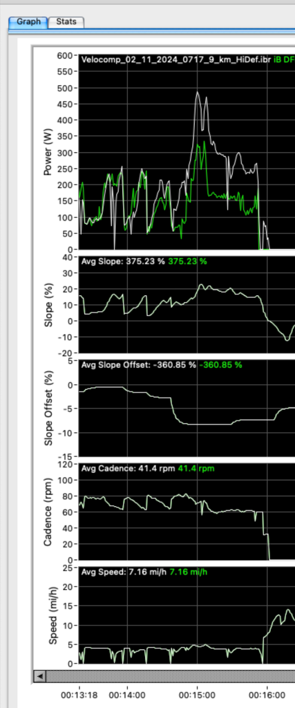

i going out today to ride on my camber PP2 Profike 2.
the powerpod record something.
here are the files.
xtrage the PP just record 1 hour but my ride was 2.
here are the files.
- Velocomp_02_10_2024_0633_10_Miles_HiDef.ibr
- (607.99 KiB) Downloaded 263 times
- PP2 Profile2 camber 10-2-24.ibp

another ride PP2 profile 2 camber either share you my garmin with my dfpm file .fit
now the powerpod its recording but my ride was 1 hour and just record 40 minutes.
- 13914489986.zip
- (105.9 KiB) Downloaded 283 times
- Velocomp_02_11_2024_0717_9_km_HiDef.ibr
- (322.49 KiB) Downloaded 313 times
- PP2 Profile2 camber 11-02-24.ibp
- (458 Bytes) Downloaded 315 times
I have looked at your ride files and something sticks out: most of the time your bike speed is only about 4 mph.
Also: there are gross discrepancies between your elevation-measured slope and the accelerometer slope. Is this ride from a mountain bike? If so do you have your front fork locked-up? If this ride was on your MTB and you did not have the front fork locked, that would explain the issues.
Please post photos of the bike you used in this ride. I know you have two bikes; the road bike Pinarello should be fine.
Have a good one I double check it the fork was blocked.
PP 2 mountain bike’s
PP 1 road bike’s
PP2
PROFILE 1 STUMPJUMPER MTB
PROFILE 2 CAMBER MTB
This was record on Profile 2 CAMBER MTB
PHOTOS:
PP 1 road bike’s
PP2
PHOTOS:
- IMG_3002.jpeg (232.7 KiB) Viewed 13200 times
- IMG_3004.jpeg (194.24 KiB) Viewed 13200 times
- IMG_3003.jpeg (185.09 KiB) Viewed 13200 times
Please do the following:
1) Remove your PP from the mountain bike where you are posting ride files
2) Attach the removed PP to Isaac and change its profile to an unused profile, using the command Edit/Edit Profiles/Set Active Profile. For example, if your PP for your MTB is set to profile 1, change your active profile to profile 2
2) Attach the removed PP to your road bike
3) Do a sensor pairing of the PP on your road bike (make sure your MTB sensors are off)
4) Do a cal ride with your road bike, followed by a 5 mile road ride
5) Download the road bike 5 mile ride and post here
This will allow me to determine if there is a problem with your PP or, perhaps, a problem with its mounting on your mountain bike
Thank you; this is good information.
Here is what appears to be going on:
1) On your MTB your lockout seems to not totally prevent your front fork from moving up and down. In general, your PP works well on your MTB. However, at the end of your climb, where you have a really steep slope, your front fork compression changes, causing the PP angle to change, causing high watts. I know this because the PP adjusts its settings continuously in response to changes in mounting angle. If there is no change in PP orientation, the "slope offset" number remains nearly constant, but on your steep hills (around time 14:30) the slope offset number goes crazy, as does the difference between PP watts (white) and DFPM watts (green).
This means that something is causing its angle to change. Does your MTB also have rear adjustable forks?
2) Your road bike ride looks fine. There are no issues with your PP performance; therefore, I conclude that your PP is working properly.
To summarize: I think your PP works well on your road bike. Most of the time your PP also works well on your MTB, but if the front fork pumps AT ALL, then where it does your PP will have problems.
