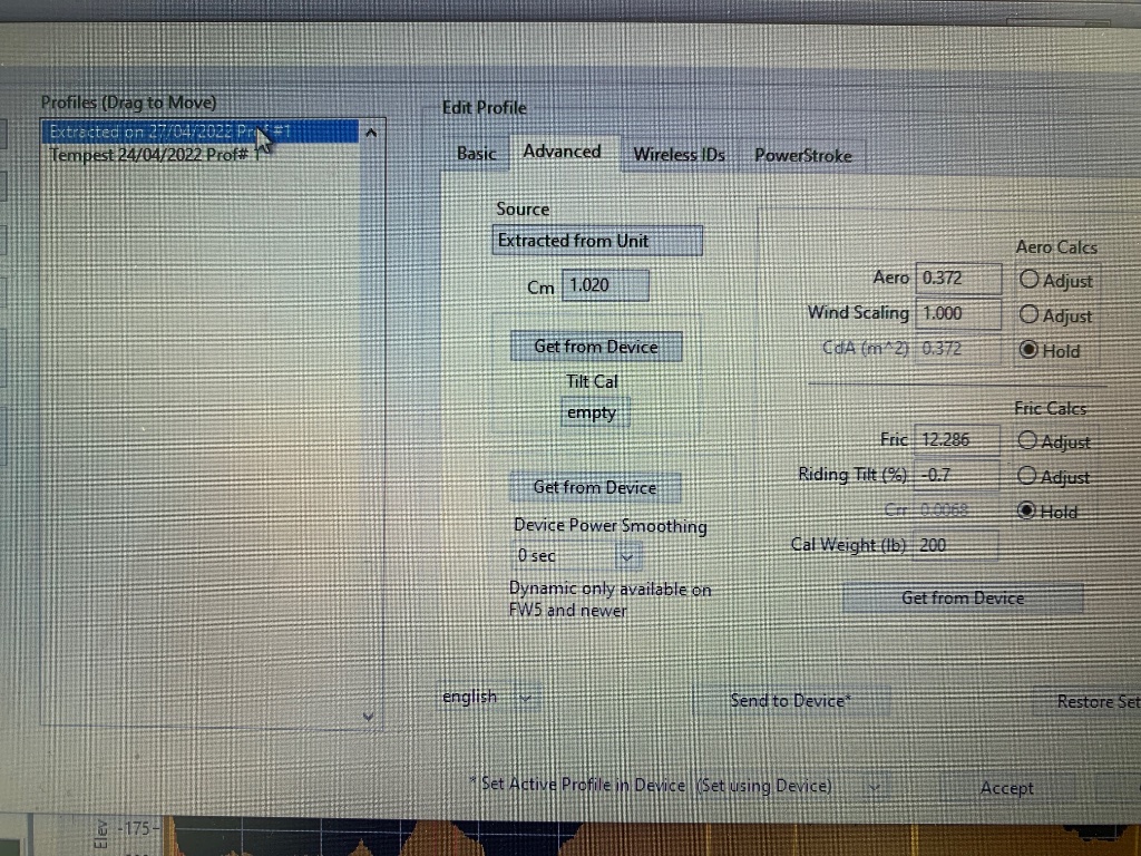

Took it out to pair, woke sensors. Turned on powerpod. Pairs then goes to calibration orange light.
Connected to laptop, extracted profile and there’s my “extracted profile 1” with aero calcs but tilt is “empty”.
Am i better off just starting set up again?
Charged
- image.jpg (421.71 KiB) Viewed 5276 times
- image.jpg (433 KiB) Viewed 5276 times
Re: Why do I need to do a daily calibration ride?
Hmm...your profile is emptySilasGreenback wrote: ↑Wed Apr 27, 2022 1:50 pm Hard reset - connected to sensors no issues.
Charged

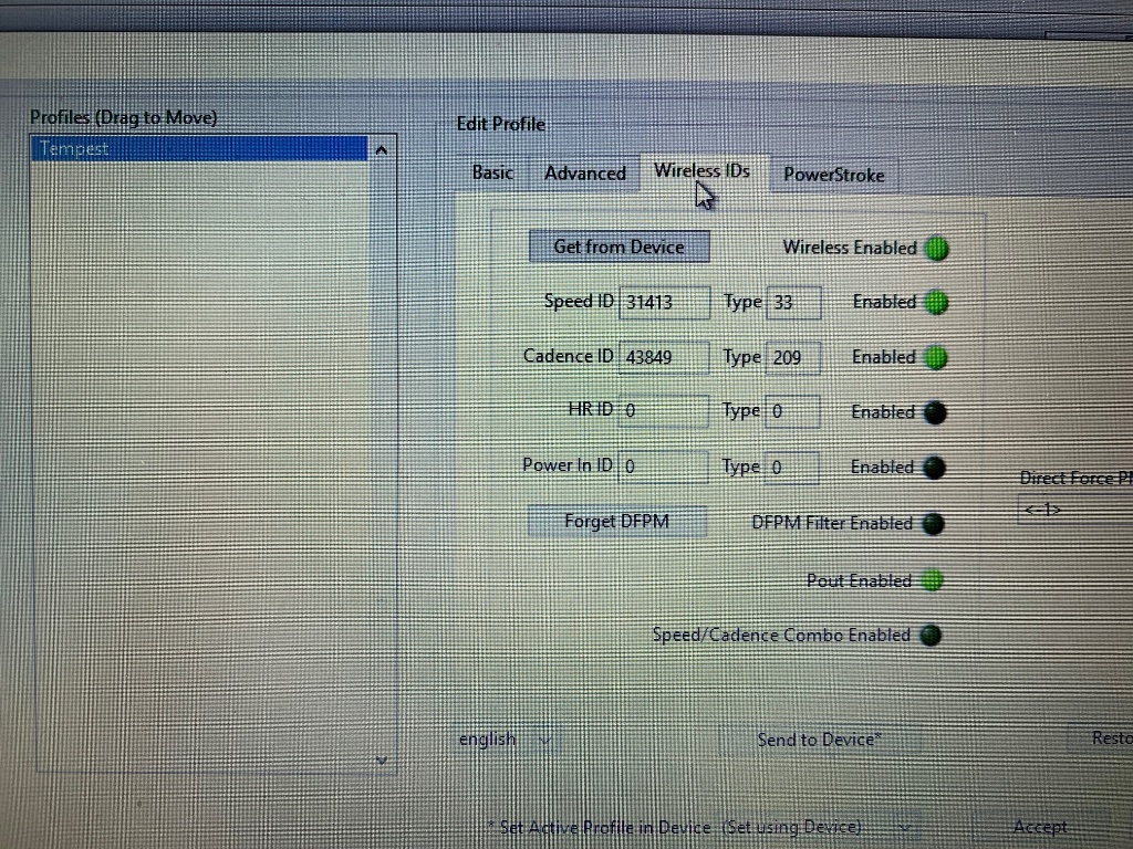

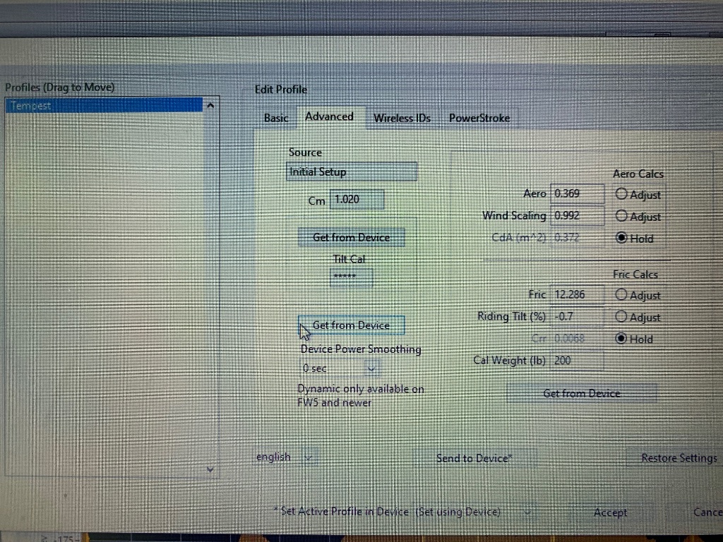

Here’s a calibrated ride:
- image.jpg (456.77 KiB) Viewed 5270 times
- image.jpg (438.27 KiB) Viewed 5270 times
