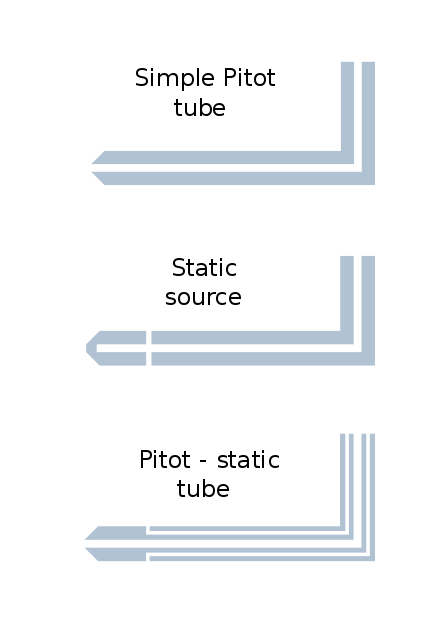

On a related note John, would a pitot tube with a right angle in it help reduce the impact of water blocking the port?
Re: Any way to use it in the rain?
spangelsaregreat wrote: Thu Oct 29, 2020 5:08 pm On a related note John, would a pitot tube with a right angle in it help reduce the impact of water blocking the port?
I don't understand what you are suggesting. Please post a picture of your idea.
lorduintah
Posts: 676
Location: Plymouth, MN
Post by lorduintah »
https://www.googleadservices.com/pagead ... hBT&adurl=
Instead of a straight tube, one the has an angle to it - not sure how well this would work in the PP situation or if you would even need two right angles to get the opening facing the direction the bike is moving in.
It would probably require the current opening to be reworked to accommodate the proper right angle
spangelsaregreat
Posts: 139
Joined: Sun Aug 13, 2017 2:53 pm
Post by spangelsaregreat »
Yes that is what I meant (picture, thousand words and all that).
