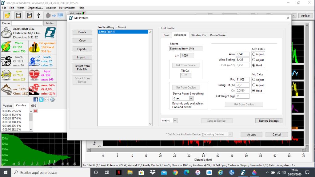

See if you can check if the watts on this route are correct. On the steepest and most rocky climbs, I think it had low watts. Attached screen to check if the data is correct.
The mtb bicycle weighs 12.70 kilograms, with 29'x2.10 wheels and 1.80 bar pressure
I weigh 68.50 kilograms and measure 178 cm.
Thanks and best regards

Attached path file, I had forgotten

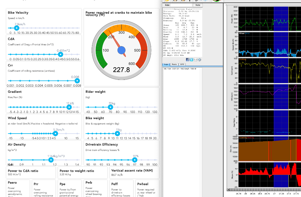

I think you're OK.
I picked out a section on a steep climb and used Aerocoach to check things.
