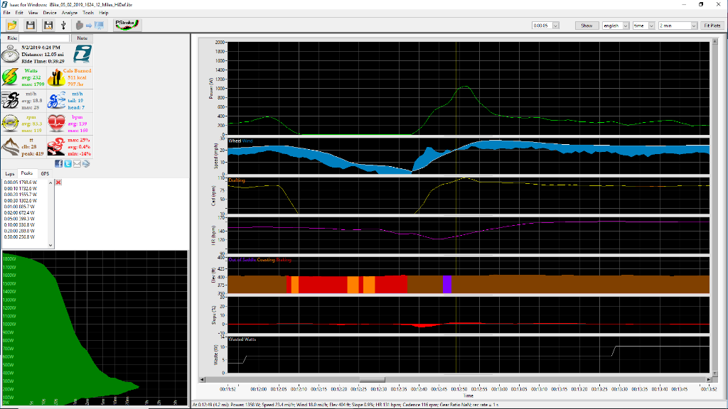

I was looking at last nights ride in Isaac and noticed this weirdness:
The peak in this photo had the power at 800 something...notice what it says about the where the line is at in this pic...1358 power yet the graph above
never even crosses the 1200w line.
What gives?

Isaac has a default setting of 5 second filtering, which is where your graph presentation is (top right of display). Set the filtering to 0 and you'll see your (very brief) spike.
