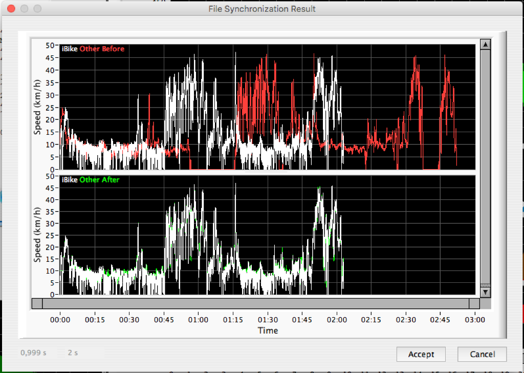

Thank you John.
IBR file is not the "original" because I merged the Garmin GPS data (in TCX format). Look at the differences while merging.
By the way, It seems like Isaac does not support FIT 2.0 file format, is that right? It does not read FIT from Garmin.

Re: CRR and CDA recommended values for MTB
Kind reminder
Your speed is showing a lot of dropouts. What kind of sensor do you have? Where is it attached?
Magene (https://www.amazon.es/210-Ant-velocidad ... B077NG5N5H) magnetless speed sensor on front wheel.
This sensor is working very, very poorly. I would replace it with a Garmin sensor.
Thank you jhon. I will try with another one.
After changing to Garmin Speed Sensor no problems anymore. Thank you John. Now results are pretty close to my normal numbers. The only thing is that there are some differences between Garmin records and PP records (about 10-12 watts average). Should I change the smoothness on PowerPod?
