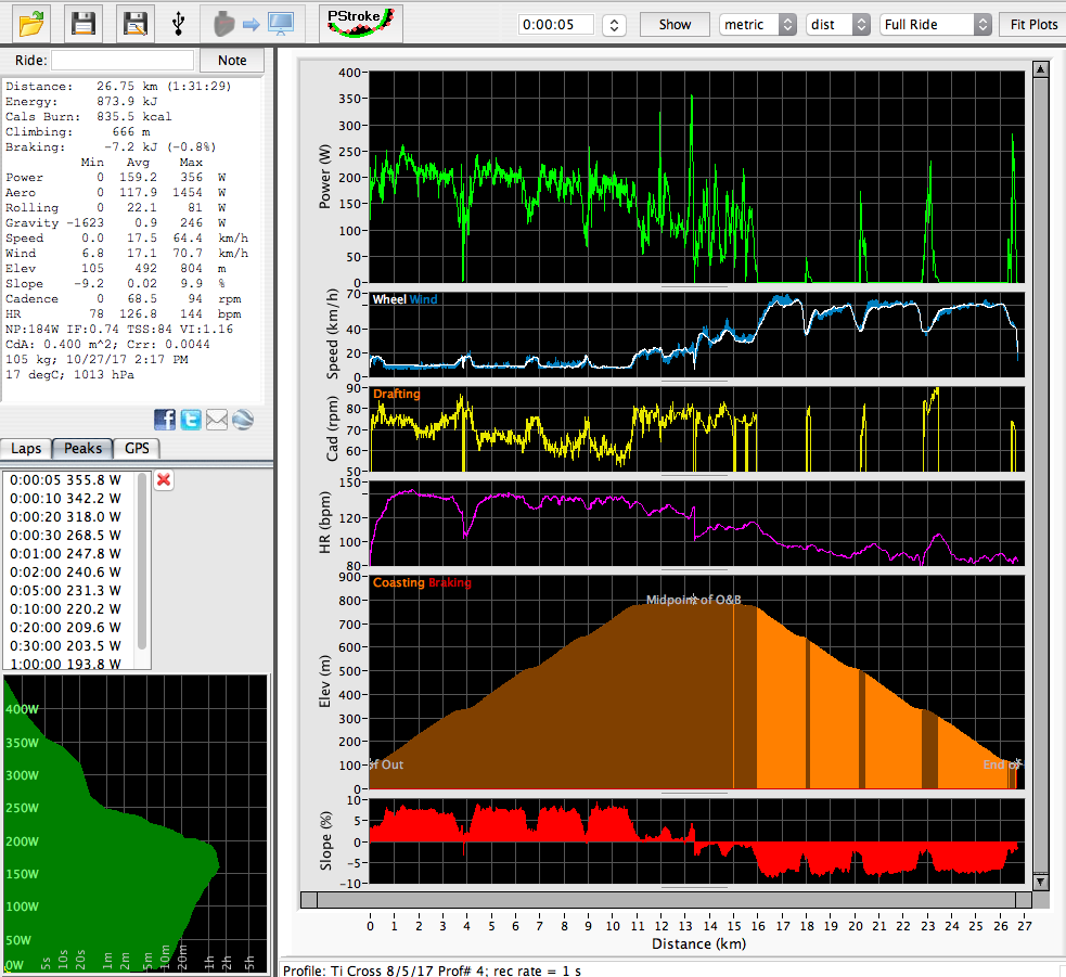

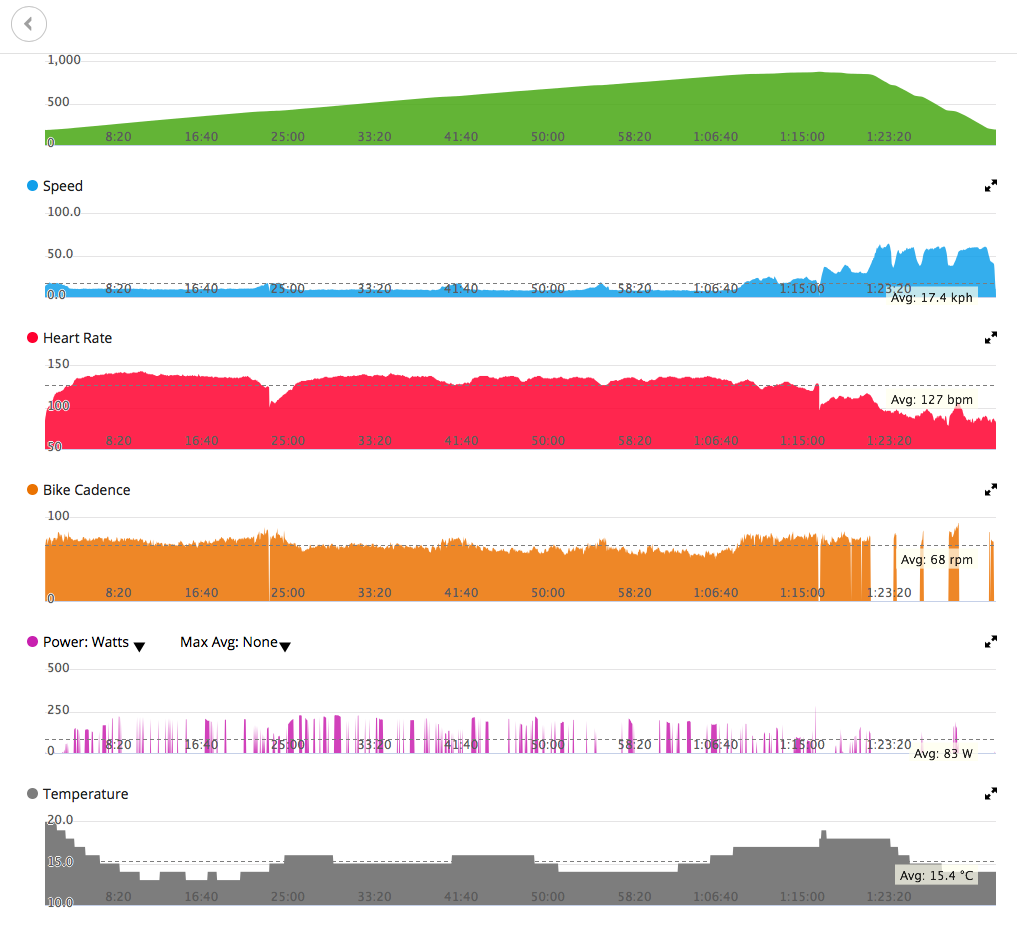

My Powerpod has been working well recently, but yesterday after I paired it with my Garmin 1000 the Garmin power reading did not display as usual, but dropped out intermittently, often showing zero watts, but sometimes showing the wattage I would expect for this ride.
After the ride, I uploaded the Powerpod ride file to my computer, and it looks normal - it's within a few percentage points of my ride on the same route ~ 2 months ago. I conclude that my PowerPod is functioning normally, but I have questions about whether it is connecting properly with my Garmin 1000.
The cadence and speed sensors on my bike are new ~ 2 months ago. The Powerpod was recharged the day before the ride.
I've attached screen shots of my Isaac screen after the ride showing the expected readings during the ride, and a screen shot of what my Garmin recorded to Garmin Connect. The difference between the power-time relationship in the two graphs is my concern.
Any suggestions on what might have caused this, and what can be done to correct it?
