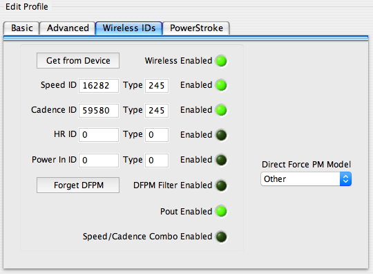

I can confirm the separate speed and cadence sensors pairing. The little LED behavior added to FW 6.21 helps a lot. I wasn't getting any PowerStroke data from my rides, although the PP appeared to pair to sensors, calibrate, record, and deliver power readings to my 520. I chatted with Tom in tech support, and he suggested that the cadence data was missing - sensor not paired or similar. I tried the pair again last night, rode today, and still no PowerStroke data.
Poking around in Isaac, I discovered the "Wireless IDs" tab in the Edit/Edit Profiles... dialog. Here I could see that the speed sensor was pairing, but not the cadence sensor - handy dialog for sure. I found this thread tonight, discovering the tidbit about FW6.21 and the three red flashes for cadence sensor pairing. Decided to try pairing again, but this time spun the wheel and crank for quite a while to make darn sure the sensors were awake, and paid careful attention to the device LED. Got the flashing green, then the three red flashes, then flashing green again, and then the solid green. After that, when I check the profile setting Wireless ID tab, I see the cadence paired! (picture enclosed).
So, looking at this dialog, is there any reason for the PowerPod to pair with my HR sensor? Or is this a Newton thing?
- Edit Profiles Wireless IDs Tab
- WirelessIDTab.png (57.41 KiB) Viewed 10249 times

The enclosed instructions for my new powerpod are very confusing. Perhaps Velocomp should include a URL directing new users to the up to date instructions (or a list of instructions based on firmware revision).AirBourn wrote: ↑Fri Feb 17, 2017 9:21 pm
Poking around in Isaac, I discovered the "Wireless IDs" tab in the Edit/Edit Profiles... dialog. Here I could see that the speed sensor was pairing, but not the cadence sensor - handy dialog for sure. I found this thread tonight, discovering the tidbit about FW6.21 and the three red flashes for cadence sensor pairing. ... After that, when I check the profile setting Wireless ID tab, I see the cadence paired! (picture enclosed).
I found the post above most helpful as I could "get from device" and confirm that I had succeeded or failed pairing the desired sensors.
I think the paper insert with my powerpod should simply direct me to the appropriate pair instructions online. Better yet, Isaac should open the appropriate instructions based on firmware version sensed. Verifying in Isaac that the desired sensors are paired should be part of the instructions.

I have 2 HR chest straps (garmin ANT+). I misplaced the one I originally paired the powerpod with. To try and pair the second HR chest strap I connected the powerpod to isaac and edited the sensor ID for the HRM. I have no idea what the "type" is so I left it as it was (type 1).
Is this a reasonable procedure for changing the HR sensor PowerPod uses? How about the other sensors (hypothetically speaking). If I got a different ANT+ speed sensor, could I just edit the sensor ID in Isaac then "push to device"? My Garmin Edge 520 will tell me sensor IDs (but not device types).
Re: Separate speed and cadence sensor pairing?
Certainly there is no harm in trying to modify the Wireless ID in Isaac. Make sure to click the "Send to Device" button!
The worst that will happen is that your HR signal is not recorded by your device.
If the profile editing does not work then do a new sensor pairing.
