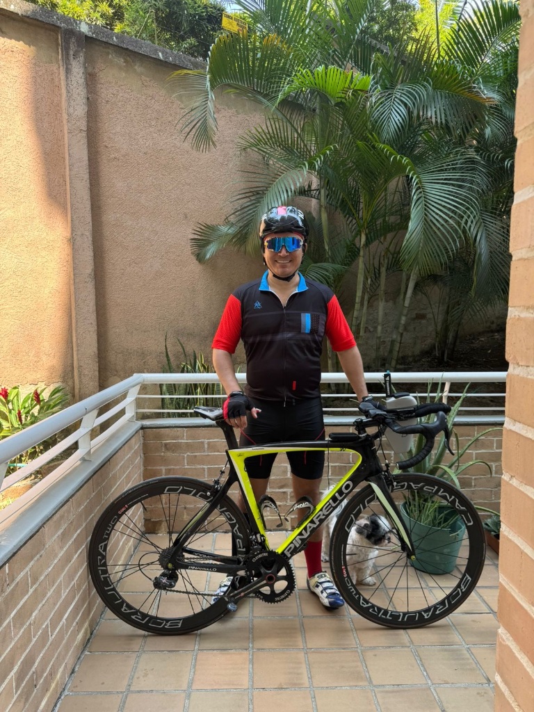

This is the bike

Re: TIRED 5 years and still useless
You confuse me enormously.
You posted a photo of your Pinarello TT bike just above but say your ride file is from a MTB.
I looked at your ride file. It appears to be from your TT bike, and if so its CdA is too high; it is set for a road bike.
I used the "Device/Check Calibration" Isaac feature to adjust your ride file to match your DFPM.
Your corrected ride file and profile are attached.
I am honestly worn out by your questions, which are not clearly stated and which involve multiple bikes and setups. I have no idea what "PowerPod2 Profile 1 Stmpjumper Fork BLOCKED" refers to. I have no idea what "BLOCKED" means. Same thing with "DogmaF8Profile 3", "Road Dogma65", "camber MTB", and more.
Unless your posts become far more specific and clear I am afraid I will not be able to continue assisting you.
Our instructions should answer most of your questions. I attach them for easy reference.
