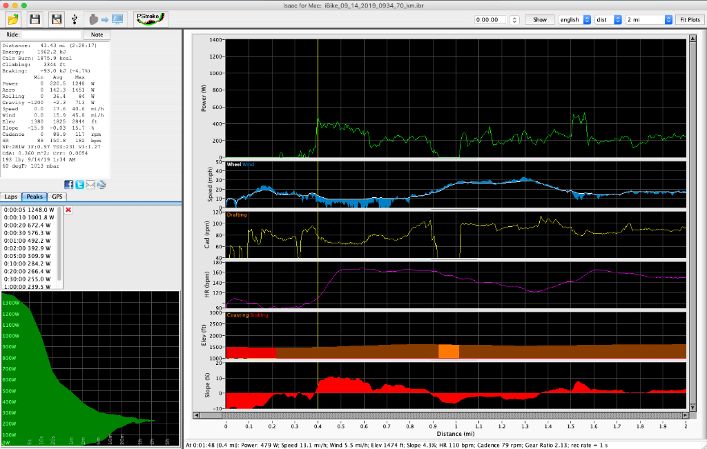

hola jhon,te mando recorrido para que puedas ver si todo esta correcto...cuando pinchas en grafico en un punto a elegir cualquiera no corresponde los watios(potencia) que marca con el grafico superior...

Everything is OK.
To see the graph numbers with highest accuracy when compared to the numbers at the bottom of the window, you need to set graph averaging to 0.

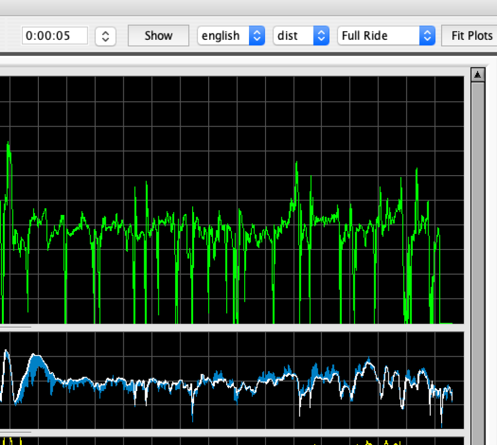

At the top right of the main window, next to the "Show" button is the smoothing filter, which is likely not set to zero
Screen Shot 2019-09-18 at 6.07.32 AM.png (101.23 KiB) Viewed 2569 times
Click on the dropdown menu and set it to zero:
