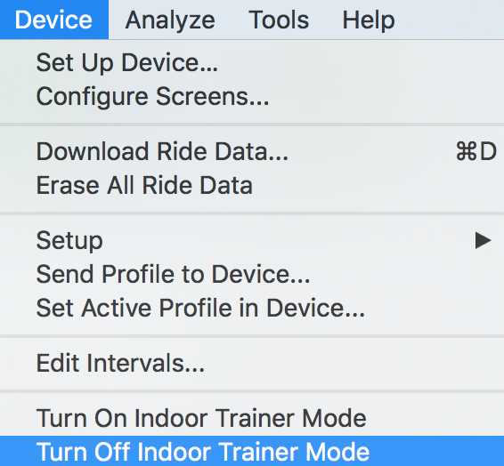

How to turn off Indoor Trainer mode
Connect your device to Isaac. Use the command "Device/Turn Off Trainer Mode".
You will get a confirming message when trainer mode is turned off.

You're still in trainer mode.
After connecting your PP to Isaac, and using the command Device/Turn Off Trainer Mode, are you getting the "trainer mode turned off" message?
If so, do a hard-reset of your PP, then turn off trainer mode again with Isaac.

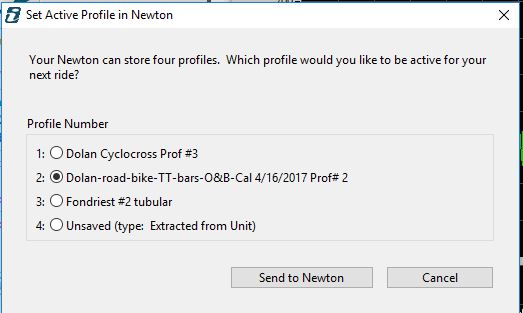

OK, here is what we think is happening:
1) "Trainer mode" is one of the parameters stored in each profile
2) Suppose you have two profiles, profile 1 and profile 2.
3) You're doing a trainer ride in profile 2. "Trainer On" is set for profile 2.
4) You finish the trainer ride. Everything is fine.
5) You then want to do an outdoor ride, using your profile 1 settings.
6) You set your PP to "Trainer Off", then you switch to profile 1.
7) THE PROBLEM WITH THIS SEQUENCE IS THAT YOU SET PROFILE 2 TO TRAINER OFF, THEN AFTERWARDS SWITCHED TO PROFILE 1.
8) Profile 1 has Trainer settings completely different from profile 2. If Profile 1 is set to "Trainer On", then profile 1 will record as a trainer file, even though you think you've set your PP to Trainer off!
So, here is the correct way to do things, assuming Profile 1 is for outdoor riding, and Profile 2 is for trainer riding
1) EACH PROFILE HAS AN INDIVIDUAL "TRAINER MODE" SETTING
2) Make Profile 1 active, then set "Trainer Off" for profile 1
3) Make Profile 2 active, then set "Trainer On" for profile 2
Now, when you switch between profiles 1 and 2, trainer mode will function properly.
In other words, when using multiple profiles, first switch your PP to the profile you're using for today's ride, then set Trainer mode (on/off) to the way you plan to ride.

If you are using the same bike for indoor AND outdoor rides, then you should have only one profile. When you switch from indoor to outdoor mode using Isaac, your single profile will "memorize" the setting most recently used. Effectively, your suggestion is already implemented for this scenario.fishyweb wrote:Hi John. I think I've previously run into this problem, as per http://www.ibikeforum.com/viewtopic.php?f=93&t=3762.
I guess the obvious question here is whether you could change the firmware so that the trainer on/off setting is independent of individual profiles. I believe that would be much more intuitive, and would avoid having to connect the PP to your PC each time you change bike for an outdoor ride to ensure that trainer mode is switched off. Could you consider this change for a future firmware release?
If you are using a different bike for indoor and outdoor rides (each bike with its own, unique speed sensor), then there should be two profiles:
1) Your "indoor" profile, where indoor mode is set to "on"
2) Your "outdoor" bike profile, where indoor mode is set to "off"
With two bikes, two profiles, and two unique speed sensors, PP will "automatically" switch to the correct profile for the day's ride, and automatically turn trainer mode on and off (no Isaac needed). To us, this seems very intuitive.

The problem is that your PP has "Trainer On" memorized in more than one of your profiles.
Do the following:
1) Connect PP to Isaac
2) Go to "Device/Set Active Profile in Device"
3) Select Profile 1
4) Go to "Device/Turn Off Trainer Mode". You will get a confirming message that trainer mode is off (in profile 1).
5) Repeat Steps 2,3,4 for your other three profiles (i.e. in Step 3, select profile 2,3,4 as appropriate). Set "Trainer Off" in all four of your profiles.
After completing the above steps, all profiles will now be in "Trainer Off" mode.
6) Now, if you use your bike with an indoor trainer that has a unique profile (for example, your indoor training is done using profile 2), go to "Device/Set Active Profile in Device", and select the profile number used with your indoor trainer (in this example, profile 2). DO NOT SELECT ANY OTHER PROFILE.
7) Once you have selected the profile with the indoor trainer, Go to "Device/Turn Trainer Mode on". This will memorize the Trainer On command, for the selected profile only (in this example, profile 2)
Assuming that all of the steps above are completed, whenever PP switches from your trainer profile (profile 2), to any other profile (profile 1, 3 or 4), Trainer mode will be turned off for all other profiles.
MAKE SURE THAT, BEFORE USING ISAAC TO SET "TRAINER ON", THAT YOU HAVE SELECTED AND CONFIRMED THAT PP IS USING THE PROFILE YOU HAVE CREATED FOR YOUR INDOOR BIKE (in this example, profile 2).
If your trainer bike has a unique speed sensor ID (i.e. the speed sensor ID on your road bike is different from your trainer bike, and you've properly paired your road bike sensors to your road bike profile, and your trainer bike speed sensor to your trainer bike profile), then PP will automatically switch from trainer mode On (in this example profile 2) to trainer mode Off (in this example profile 1, 3 or 4) automatically.
As long as you are careful to use only one profile for indoor training (that is, you use the "Trainer On" command only with the same, single profile number) your problem should disappear.
3) Select Profile 2
4) Go to "Device/Turn Off Trainer Mode". You will get a confirming message that trainer mode is off (in profile 2). Whenever you select profile 2, you will be in "outdoor" mode
5) When you're using bike 1, use Isaac to select profile 1.
6) After making sure that Profile 1 is active, use the Turn Trainer Mode command to turn indoor training on/off (as you desire).
7) For profile 1 only, until you manually change profile 1 settings with Isaac, your PP profile 1 trainer setting will remain in On (or off) until you change it.
8) Whenever you switch to profile 2, trainer will automatically be turned off.
