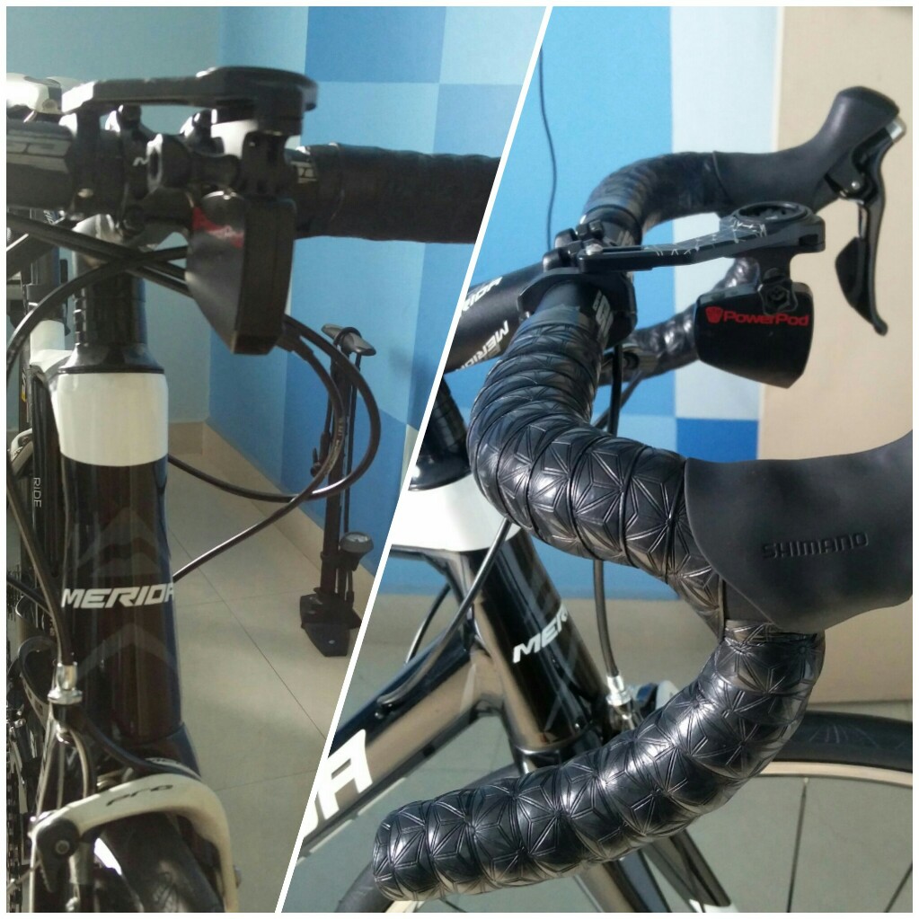

Hmm...your wind sensor appears to be getting partially blocked. Please post images of your PP mounted on your bike, front, side and top views.
drashkum
Posts: 70
Joined: Fri Oct 14, 2016 9:40 am
Re: Autocalibration after bike fit
Post by drashkum »
This is the picture. I had been using this out front combi mount as i was not able to mount my garmin on to the 70mm stem. Now that stem has been changed to 100mm i can still go back to the oem mount that came with my PP. Should i do that?. I am seeing that all these problems started only after the use of combi mount. till then everthing was consistent
Posts: 8008
I would try the original PP mount. Do an out-and-back calibration and then post the .ibr file.
