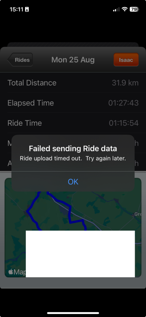

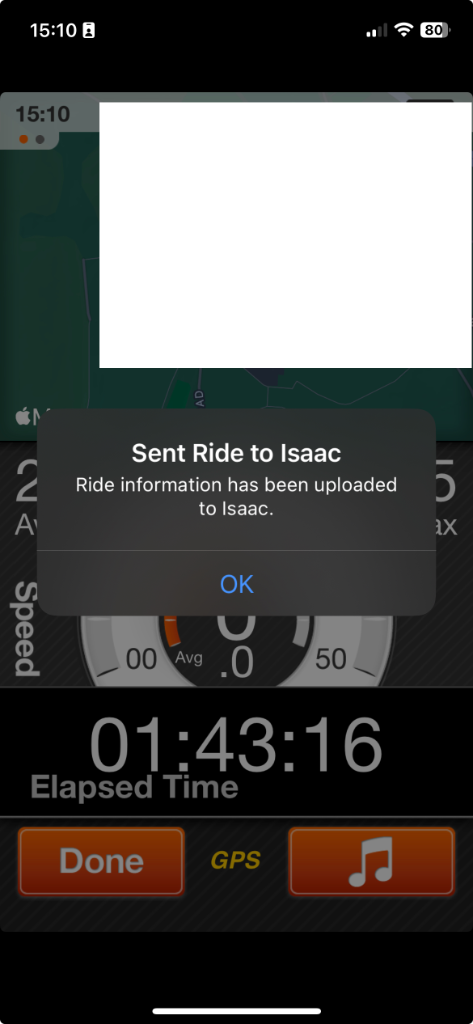

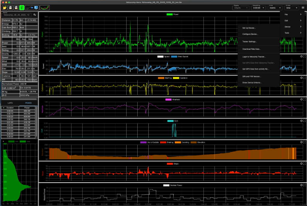

I managed to get out for a short ride today. I ran Velocomp Tracker on my phone from the start to the end and uploaded afterwards - see: After connecting my PowerPod to my Mac and downloading the ride file, I open the ride I just completed and select (from the burger as shown in the image) "Device" then I see an entry for "Get GPS data from Velocomp tracker" but this option is greyed out: I have verified that I'm logged in (albeit without a confirmation).
I also noted that if I open the ride in Tracker then select the Issac button, it tries to upload, but fails with an error (I assume because the file has already been uploaded?), see: Later I will try to copy the ride file to my Windows computer to see if I can get to the tracker/ gps data..

I just tried uploading to NT. It worked without problems...
