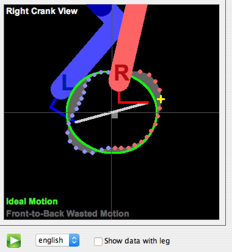

Maybe I'm missing it but is there a way to see power generated by left leg vs. right leg in Isaac? I see wasted watts, etc (yikes, btw) but would love to be able to see L/R power.

The left and right legs of most cyclists do not apply power equally as they turn the crank, nor is each leg equally as strong.
If you look at the crank plot of PowerStroke you'll see how your left and right legs apply power, every 10 degrees as you turn the crank. The PowerStroke distribution shows how your legs are accelerating the bike, as you turn the crank.
If one leg is stronger, then more acceleration dots from that leg will extend outside of the green oval.
If one leg is "lazy", then the number of dots outside the circle will be fewer.
If your legs are equally balanced, if your cycling technique is strong, and if you have a great bike fit, then the dots will adhere very nearly to the green oval at nearly all points.
That's what PowerStroke tells you.
In the image below, from one of my recent bike rides, my right leg is doing a lot more work than my left leg--both in terms of strength, and in terms of the amount of time it is working.
So, I need to work on my left leg.
The other guys give you a simple L/R power split. Why nothing more? It's because strain gauge sensors can't usefully measure what is really going on.

- Screen Shot 2017-05-08 at 3.52.19 PM.png (48.29 KiB) Viewed 49831 times

Thanks for the explanation! Would still be interesting to see a balance number. It would even be cooler if one could see balance in the Garmin headunit in real time. Don't know if you are able to distinguish with enough accuracy to do that?

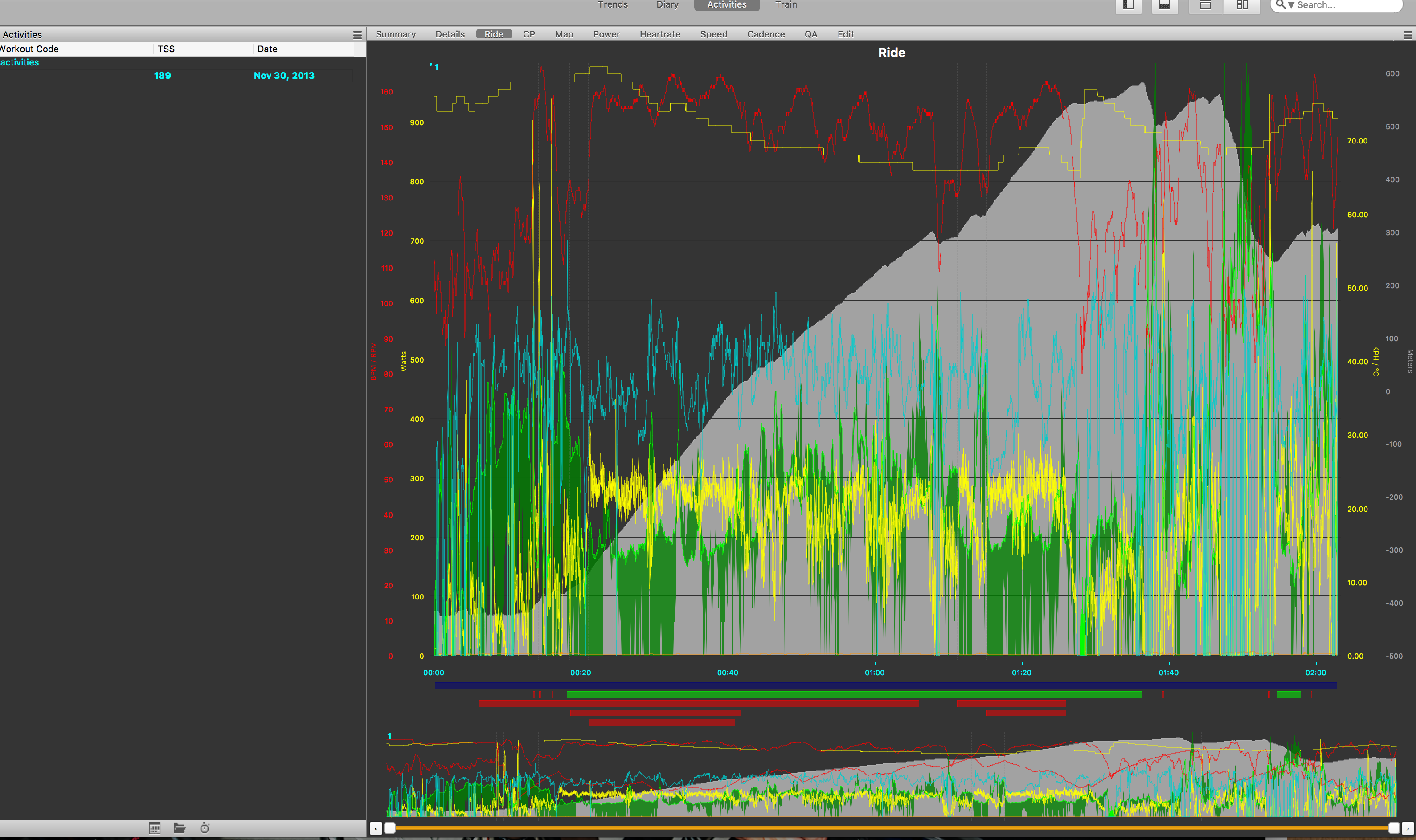

I would suggest to integrate the powerpod specific functions into GoldenCheetah, and use GoldenCheetah as a foundation. It could be a good mix.BBQcyclist wrote:Re. "...as a fan and customer of velocomp or pp, the isaac really neeeds to be upgrade in terms of look and feel..."

Well, I know I'm going to get into trouble for this post...
For the first time ever I downloaded Golden Cheetah. I opened it up and (I think) was presented their sample ride file. This is the screen GC presented to me. I took a screen shot of it, below.
Really?
GC may have some interesting analytical capabilities, and I'm sure that, after you "learn" GC, it can be useful.
But this kind of daunting data presentation will, in my opinion, cause too many cyclists throw away their power meter.
Really?

Don't know if your screenshot is the default view or not, but i do like this kind of representation:
Summary:
http://www.goldencheetah.org/img/RideSummary.png
In wich PowerPod could include their own metrics specially from PowerStroke, CdA when available, DFPM power and PowerPod power and so on.
More detailed graphics:
http://staminist.com/file.php/1/359/gol ... t_copy.jpg
In wich powerPod could include their own metrics (CdA, wind, wasted watts, and so on).
Out of that, specially trends is very useful, in Isaac there is no way to "plan" and "track" a season.
I don't mean that GC is the perfect tool, nor the best look and feel, just mean that it could be a good foundation...
