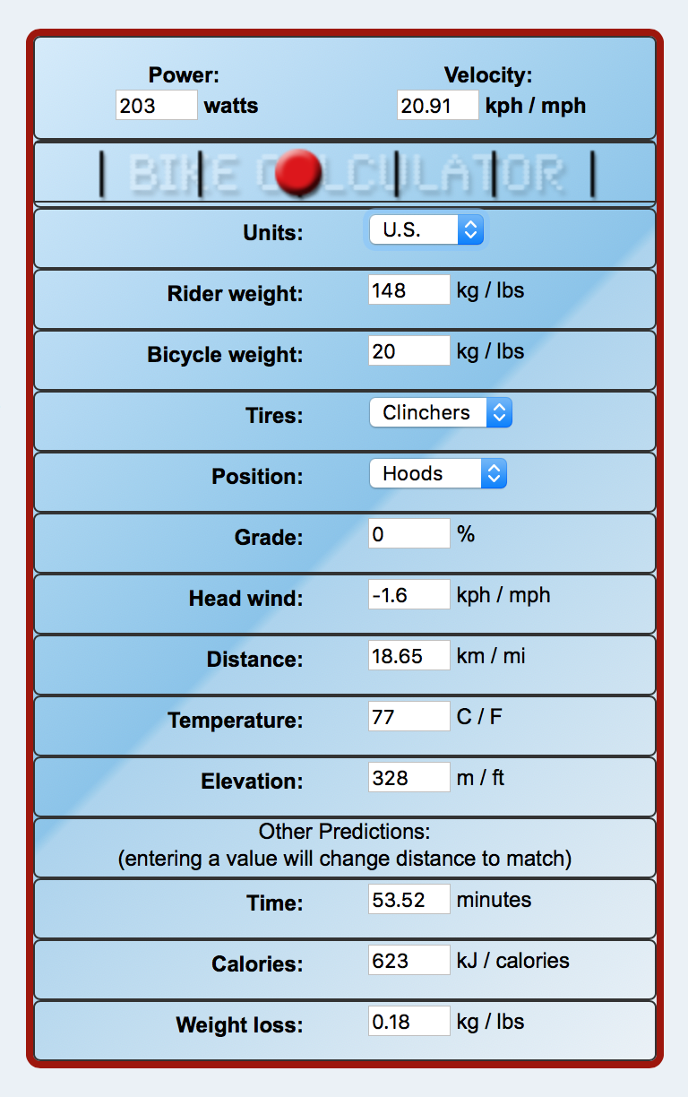

I think you are fine...
1) I have a "rule of thumb" 20/20 approximation: on the flats, at 20 mph, you'll need about 200W
2) To use bike calculator you need to pick a place where conditions are constant. I did this for the place shown; your Newton measured 195W and bike calculator, 201W
3) At the end of your FTP test you had some "gas" left in the tank. You probably could have biked with more power during your test...

Ah, thanks! Looks like I entered the incorrect wind speed (average ground speed makes sense when I think about it).
