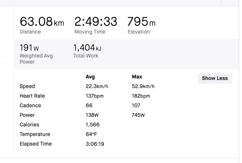

I don't find a way to extract the gpx file from Strava...
The only thing I see is that Strava says your ride was 63km, but the .ibr ride file says it was 71km. That may make file sync difficult
Screen Shot 2022-05-08 at 4.06.37 PM.png (96.97 KiB) Viewed 8591 times

Hello,
Indeed this was the problem. I did a 8 km ride to get to the group and this wasn't included in the strava file. After merging the 2 gpx files everything went fine. Thanks for the help.
Kurt
